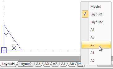

To activate a layout (to set it current) just left click on its tab. If there are many of layouts in the document, to move from one layout to another, use the
The current layout in the context menu is marked with the
icon.
