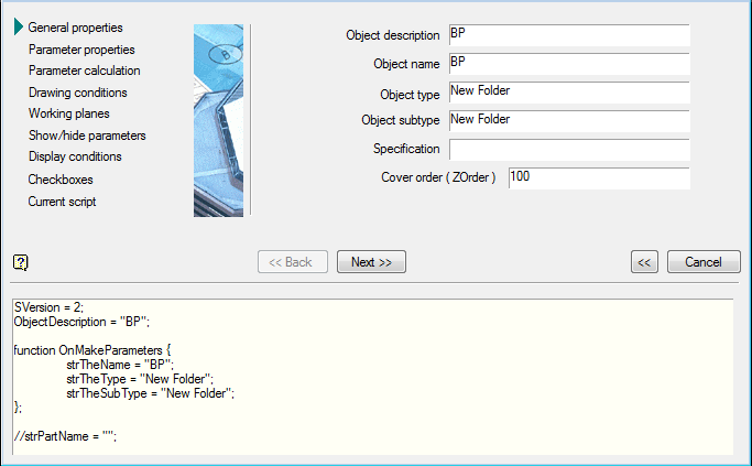

Basic properties
Object description (Property Description). This parameter is optional, it describes the common name of the object. For example, nut, bolt, etc.
Object type (type). This parameter is required, it is advisable to fill it in Latin characters. Serves to identify the object as belonging to a group. For example, StdArborParts – standard parts shaft, StdJointParts – fastenings.
Object Name (Name of facility). This parameter is required, it is advisable to fill it in Latin characters. Defines elements within the group, given strTheType. For example, a screw bolt – Screw, for nuts – Nut, for washers – Washer etc.
Object subtype (subtype). Additional parameter, it is desirable to fill it in Latin characters. Defines a specific subtype of GOST. For example, if the name of the object – Nut (Nut), then simple nuts subtype is Simple, from crown – Castle etc.
These parameters set by the user, based on its project object interaction, and can be arbitrary. Hard list is not, and they can be changed at any time. They will only be used in scripts to automatically establish dependencies (details – in the description of scripts).
Specification. Description line items for transmission specification.
