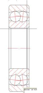

Insertion from the database. The database is organized as a hierarchical structure of objects having similar functions. (For example, the details of arbors, pipelines etc. are grouped). There are also different types of objects: the groups and the markers of the objects. You can search for the required standard in the database. When inserting a detail, specify the insertion point and the direction of the detail’s local X axis (position and orientation of the detail). The details can be fully displayed or displayed as a representation of the base plane. The position of the detail is specified by a click, the orientation by a double-click.

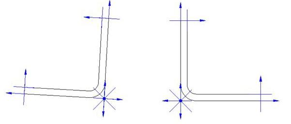

The grips are very useful tools to edit objects, and if the object has grips, they add additional functionality to the object. You can move, rotate and mirror the object, using the grips; you can also change the standard size of the detail, visually set the details parameters and define the direction of the drawing.

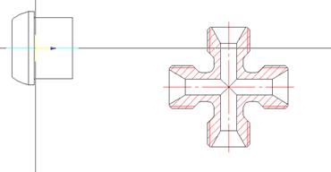

The standard database of the program behaves intelligently towards the other objects in the drawing. For example, when the pipe fitting with the internal cone is inserted, the nipple, inserted after it, will be automatically connected with the fitting.

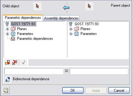

It is achieved by specifying parametric and geometric dependences between the details. The dependences for the details should be set according to the standards.
The user can set the dependences for the objects already placed in the drawing (for example, if the automatic connection is not specified). These dependences are custom and are stored in the drawing.
