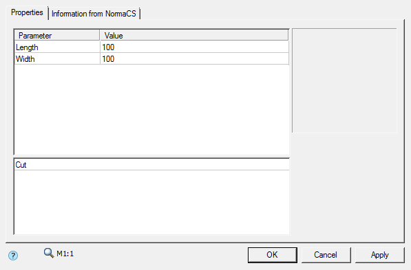

Let’s insert an object (hereinafter Object1). When placing an object on a drawing, a window with default parameters will open.

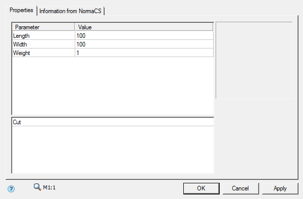

Let’s insert an object (hereinafter Object2). The dialog correctly displayed the line weight to us.

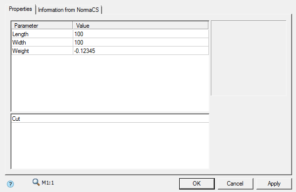

Let’s open Object1 for editing and see that the “Weight” parameter is displayed incorrectly.
The point is that Object1 already has version (seted) 1 and the weight is not assigned.
