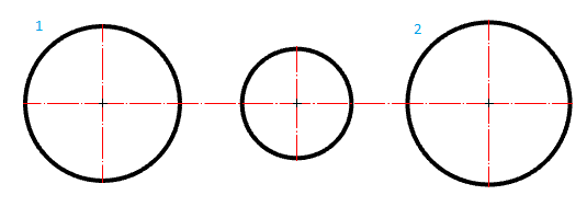

  • Two or more circles. Draws centerline centerlines on selected circles with one common centerline.
1. Call the command Centerlines”.
2. Select the first circle.
3. Select the second circle.
4. Press the “Enter” key. If on the line between the centers of the two selected circles there are also centers of other circles, then for such circles, axial ones will also be built.

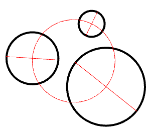

  • Three mismatched circles. Creates a circle of centers passing through the centers of the selected circles. Center axes are automatically added to all circles whose centers coincide with the constructed center circle.
1. Call the command “Centerlines”.
4. Select the third circle.
