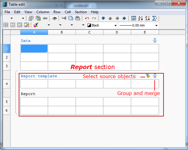

Report creation
Reports are used to arrange information about objects in the drawing.
To create a report, select Insert Report section from the Section menu in the table editor.

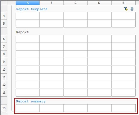

A report consists of two sections: Report template and Report.
The report template defines how the content is displayed in the report and can contain one or several lines. A copy of the template rows is created for every object. Formulas are calculated according to the properties of the selected objects.
The report template contains the variables of the selected objects; the values of the template variables are displayed in the report.

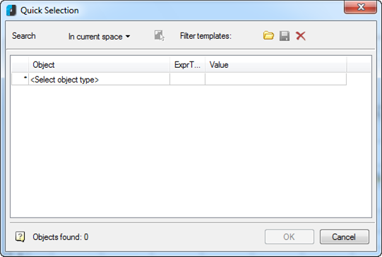

Using the Select source objects
tool you can select inserted objects according to the required conditions.
In the Grouping and merging
dialog box you can specify the settings for grouping and merging table cells.Report template menu:
- Report header adds a report header row to the beginning of the report;
- Report footer adds a report summary row to the end of the report;

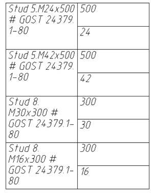

Vertical grouping

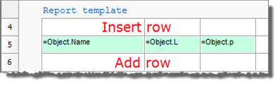

A report template can contain several lines. Cells with identical values can be merged. From the right-button menu select Insert row or Add row.
When adding a row, it is added after the selected row, but when inserting a row, it is added before selected row.

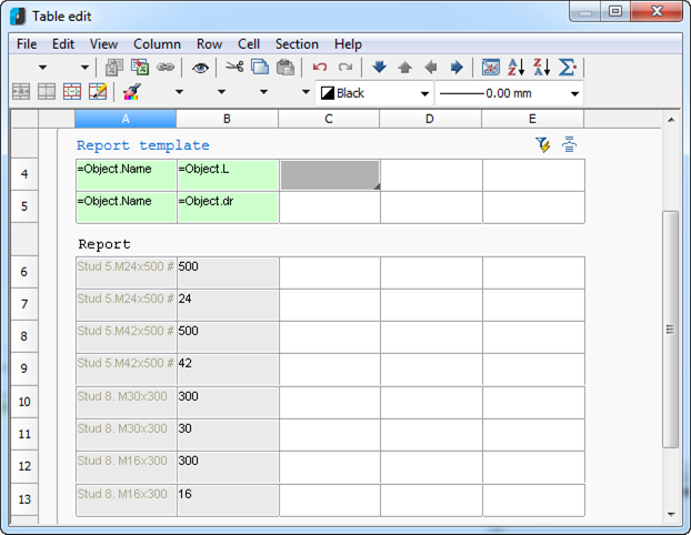

Setting variables for rows. Select A4 and A5 cells and from the right-button menu select Group.
The selected cells will be grouped. The table will be displayed as follows:
There are cells in the report highlighted with special colors.
If you edit such cells, changes are applied to the object to which they belong.

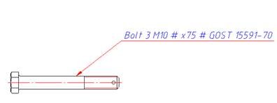

Create a table and report template.
Add the parameters: =Object.Name and =Object.L.

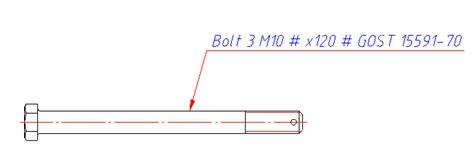

Enter a new length, for example 120.
The bolt’s length is changed.
