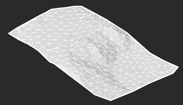

Create TIN by points
The command creates a TIN (Triangular Irregular Network) surface – an irregular triangulation network by point objects represented by Points, Geopoints or Blocks. The following objects can be created: SubMesh, Polyface mesh, Solids or 3D Faces.
A set of points for creating a mesh can be obtained by importing from third-party formats or from a point cloud with the Explode the Cloud into Points command.
