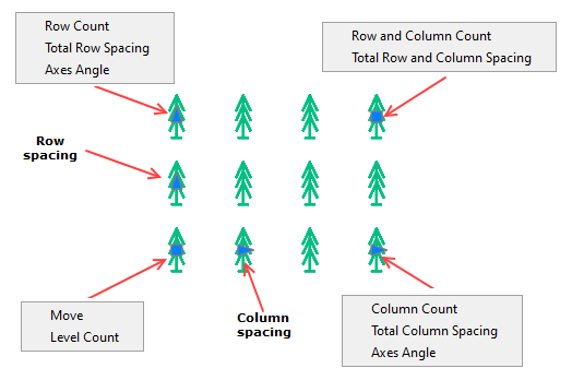

You can edit a rectangular associative array using grips. When you move the cursor over a grip, a menu with parameters available for changing is displayed.
