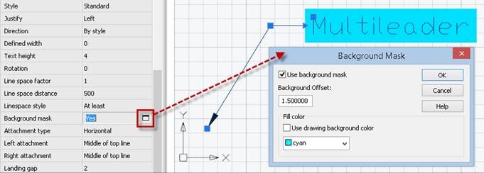

Select the multiline text, multiline multileader text or multiline block attribute text.
on the Properties panel, click the button to the right of the Background Mask parameter (the Text section):

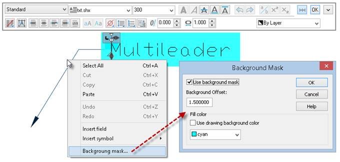

Or select the Background Mask item in the context menu, while editing multiline text (or multileader multiline text, or attribute multiline text):

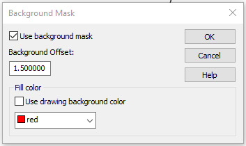

In the dialog that opens, configure the parameters.
Use Background Mask Whether or not to hide the background of multiline text.
Background Offset The size of the mask margins around the text area.

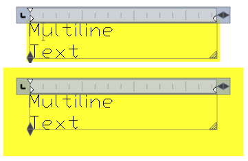

The coefficient value is tied to the height of the text. If the coefficient value is 1, then the size of the mask corresponds to the size of the text area. With a value of 1.5, the background extends out of the text area by a distance equal to half the height of the text. Cannot be less than 1.
Below is the result for values 1 and 2.8.
Fill color Mask color. Use the current background color or set your own.
