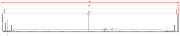

In the model space, a one-to-one (in real units) projection is drawn with an overall horizontal dimension of 500 mm.

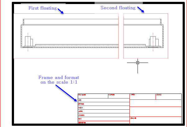

Result projection design in paper space.

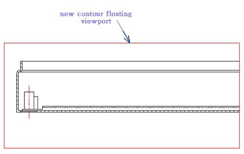

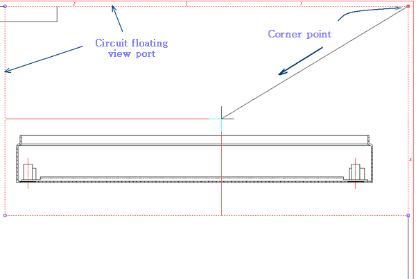

3. Let’s change the size of the floating screen. To do this, click on its outline with LMB and move the highlighted corner points. Part of the projection will then be hidden by the outline of the viewport. We have made a kind of cropping of the image. You can also delete the existing viewport and add a new one of the required size.
Move the corner points of the floating viewport
Result after the transfer of the image projection of the angular points of the contour floating viewport.

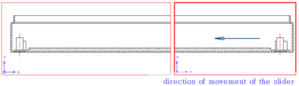

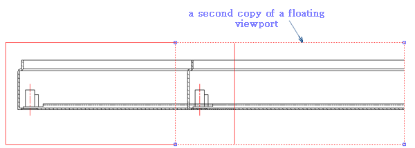

5. To obtain an image of the right part of the projection, we will make a copy of the floating screen and move it to the right.
Move the screenshot to the right.
6. Using panning, we will set the view of the right part of the projection inside the right floating viewport. To do this, double-click LMB inside the viewport outline.
Changed the boundary of the right floating viewport.
