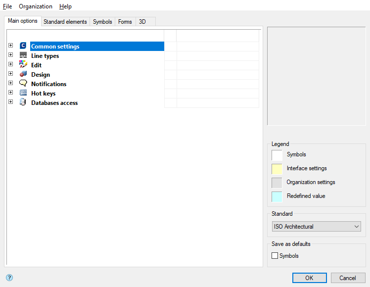

Work area
Contains:
1. Tabs with settings settings:
- Main options
- Standard elements
- Symbols
- Forms
2. Graphic window for displaying custom parameters (not editable).
3. Container “Legend” with the legend of the kind of settings (not editable).
- Symbols – parameters with this background refer to the design parameters.
- Interface settings – parameters with this background refer to the interface parameters.
- Organisation settings – parameters with this background indicate that they were downloaded from the Organization settings.
- Redefined value- parameters with this background indicate that they have been changed by the user.
4. The “Standard” container is intended for displaying the default development system of the design documentation (the choice is possible if there are more than one standards).
5. The “Save as defaults” container contains configuration items that indicate what will be saved by default when you click the “OK” button. Contains the selection field “Symbols”.
