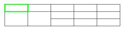

The active cell is highlighted with a green frame. The text entered into the cell is automatically pre-pressed.

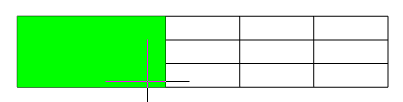

  • Pick the first corner point of the selection.
  • Pick second corner point of selection.
  • Selected cells will merge.

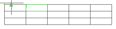

  • Call command.
  • Pick the first point of the dividing line on the table border.
  • Pick the second point of the dividing line on the table border.**
  • The cells that the dividing line will pass through will be split into new cells. Each cell is independent.
