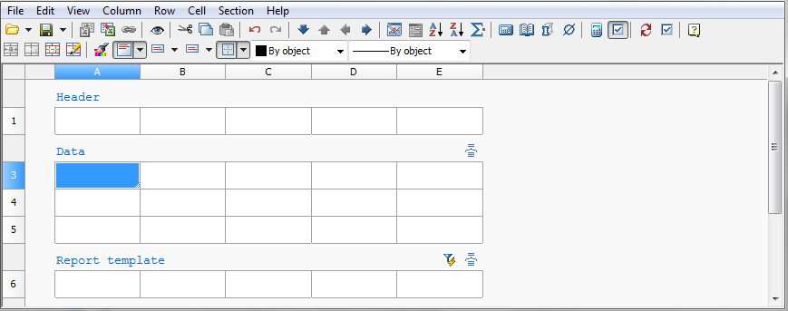

Generating a report
To create a report in the table editor, call the command from “Main menu – Section – Insert Report section”. The command will create a subsection “Report template”.
Additional subsections are added using the “Report template” menu: “Report title”, “Report Summary”.
Header and footer sections are added from “Main menu – Section”.

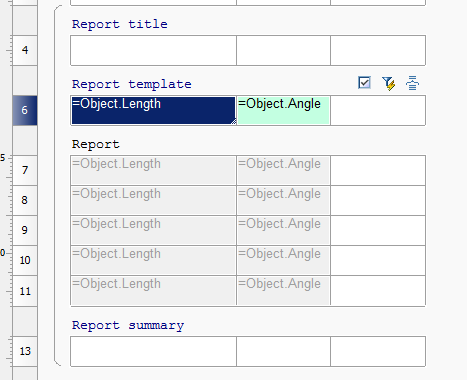

Report template
The report template defines the content and appearance of the report; it can consist of one or several lines. A separate copy of the report lines is created for each object. Formulas in the report are calculated using the properties of the selection objects.

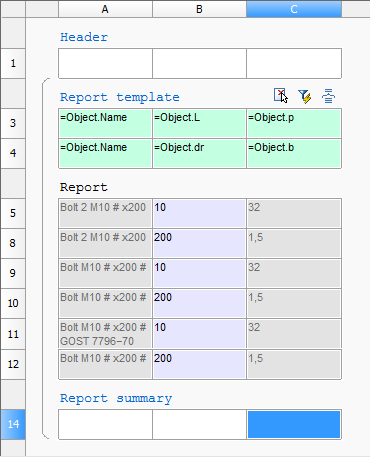

Report
The “Report” displays the values of the template variables.
The report contains cells (with a lilac background) containing object data, marked with a special color. Selecting cells highlights the corresponding objects in the drawing.

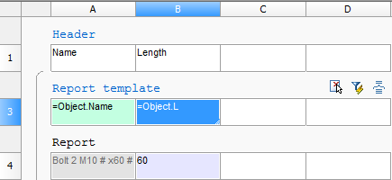

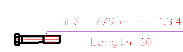

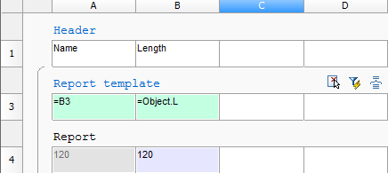

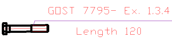

When editing such cells, the changes will be applied to the very object to which they refer. For instance:
1. Take a Bolt GOST 7795-70 with a length of 50 mm and place a leader on it.
2. Create table, report template and tie to bolt (parametric object).
3. Add parameters: Object.Name and Object.L.
4. Enter the new length, for example 120. Close the table editor.
5. The length of the bolt in the drawing has changed.
