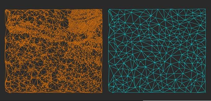

Simplifying the Mesh
The Simplifying the Mesh command performs triangulation network optimization. The optimization goal is to obtain a more sparse mesh that retains its form.
The command options are set in the Properties bar.
