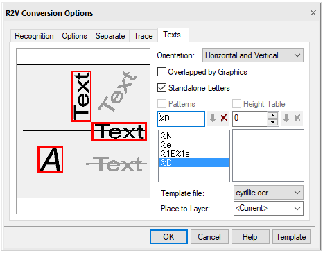

The text search and recognition module parameters are configured in the Texts tab of the R2V Conversion Options dialogue box.
Texts tab
Processing of raster texts is divided into two stages. First, the program searches for raster fragments containing raster texts. These fragments are called text areas.
Then the program applies to the found raster texts the operation specified as an additional parameter of the Text area algorithm in the Recognition tab.
One of such operations is raster text recognition using the built-in text recognition module (OCR).
The OCR module recognizes raster texts and creates text objects. It calculates the height and rotation angle of the created texts.
The program contains a file of OCR letter patterns (DEFAULT.OCR and CYRILLIC.OCR), with which the module recognizes English characters, digits, punctuation marks and special characters (the first half of the ASCII table). In addition, you can train the OCR module to recognize any other text characters.
If OCR cannot recognize a character, then that character is replaced in the text line with a “~” (tilde) character. If all the characters in the word are not recognized, OCR does not generate a corresponding text object.
Text recognition options
Orientation
Specifies the acceptable orientation of raster texts:
- Horizontal – searches for horizontal text lines. Text areas will be only horizontal;
- Horizontal and vertical – searches for horizontal and vertical text lines. Text areas will only be horizontal and vertical;
- Arbitrary oriented – searches for all text lines. Selecting this option can slow down the search for text areas.
Overlapped by graphics
When this option is enabled, the program searches for raster texts related to other raster objects. Selecting this option can slow down the search for text areas.
Standalone letters
Searches for single text characters. If this option is disabled, the program will not find single text characters, but it will also not recognize graphic objects, markers, dashes, etc. as text.
Patterns
To customize OCR, define a set of word patterns. A word pattern is a rule that defines the allowed sequence of characters within one recognized word. The OCR module will only recognize words that match one of the specified patterns (patterns are listed in the Texts tab of the R2V Conversion Options dialogue box).
