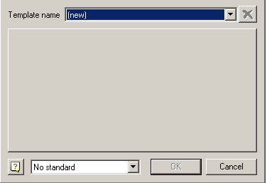

To change the existing format, select it from the drop-down list of templates. The field, located in the center of the panel will be a general view of the selected format.
To add a new format, select the drop down list “Template name” paragraph (new).
Click the left mouse button on the center field, select the drawing created by pre-layout format template, and confirm the selection click OK.
In the dialog box “Format creation” will be recognized image format.
If you create a new format after closing the dialog box by pressing OK, a dialog “Create element”, which follows the format and select the name of the folder in the library of standard parts, which will save the created format:
By default the path “DB \ Drawing borders template”. If you want to keep the format in another folder, press and select the folder that appears in your browser.
