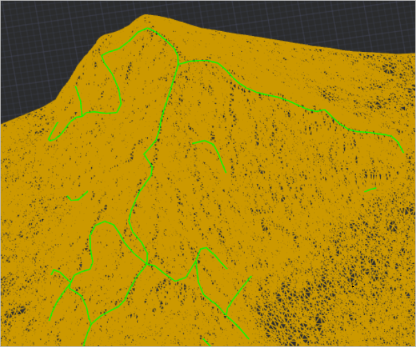

If the value of the Resolution parameter is too low (high resolution), the slightest bends in the relief will be detected, but smooth bends, which are more important in terms of the key lines of the relief, may not be detected. So, if you are creating a lot of scattered small lines, the value of the Resolution parameter is most likely too low.

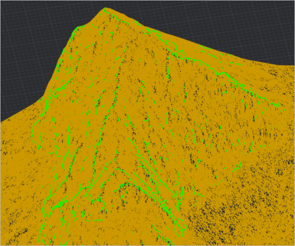

If the parameter value is too high, the opposite picture is obtained: there are few lines and they are very inaccurate. If at the same time the Isolation Distance parameter, which is responsible for the integrity of the lines, is set twice as high as the Resolution parameter value, then the lines will be even smaller and they will fall apart, and if set much more, the lines will stick together where they are not needed. The example below shows just such a situation: too high a value for the Resolution parameter with a large value for the Isolation Distance parameter.

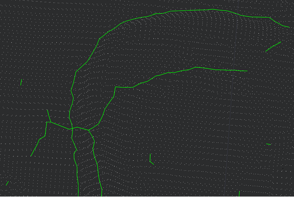

Smoothing Pass band and Smoothing Iterations are parameters for smoothing lines. It makes sense to change them only if the lines seem to zigzag and they should be smoothed out even more. In this case, you can try to increase the number of iterations. In most cases, you do not need to change the parameter values. Values of the Smoothing Pass band parameter are set in the range from 0 to 2, smaller values correspond to more smoothing.
The example below shows lines obtained from only one iteration. They are practically without smoothing, you can see that they go a little zigzag.
