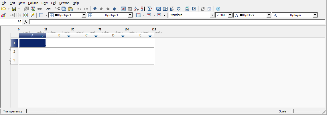

The interface is opened by double-clicking on the table, or by selecting the “Edit” command from the context menu of the selected table.
The dialog box contains:
*main menu;
*%(color-blue)toolbar%;
*parted cells with names (addresses) of rows and columns;
*status bar with transparency and scale caret;

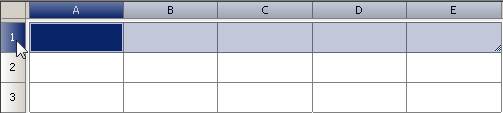

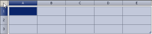

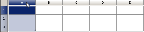

When you click LMB on a row or column name, it is selected.
To select the entire table, select a rectangle at the intersection of the row and column names.

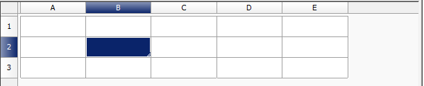

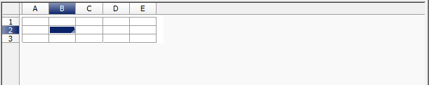

The shortcut “Ctrl + scrolling mouse wheel” allows you to change the scaling of the table.
The shortcut “Ctrl + click mouse wheel” sets the default table scaling.

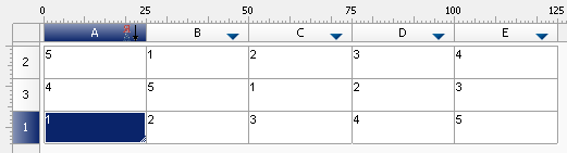

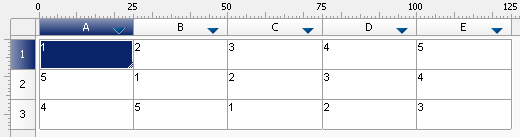

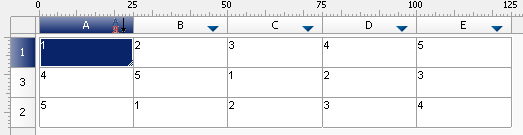

When “View sorting” is enabled, sort buttons appear on the right side of the column headings. This sorting is intended to improve the convenience of entering data in the spreadsheet editor and does not affect the state of the table in the drawing.
The button has three states: “Not”, “Ascending”, “Descending”.
Not
Ascending
Descending
Sorting features:
*Enabling sorting on one column disables sorting on other columns.
*Rows are sorted whole, not just the column.
*Strings are sorted within a section.
*The merging of cells is not broken.
*After enabling view sorting, the vast majority of commands are blocked. Allowed: exit, edit single cells and change sort mode.
