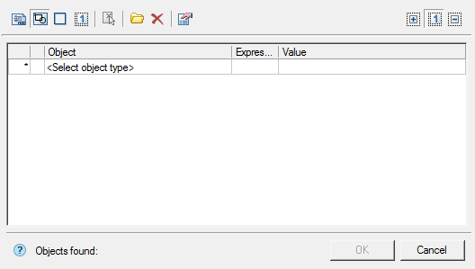

Dialog
The dialog box consists of a toolbar and a list of search conditions. At the bottom left of the dialog, the number of objects found according to the specified search conditions is displayed.

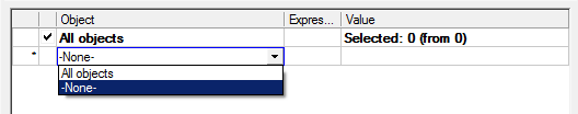

“Object” – displays objects and their parameters. If you selected the search area “In the whole document” or “In the current space” you must add objects yourself. In the “Object” column, select the desired type of object from the drop-down list of the cell. To deselect or remove an object from the table, select the “None” value.

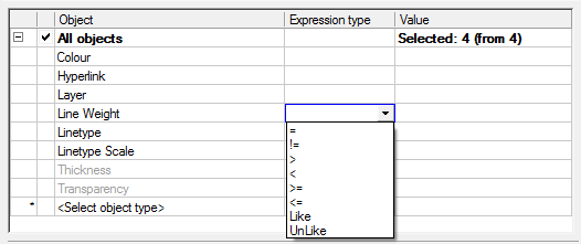

“Expression type” – a comparison operator is assigned to object parameters. Each type of object has its own parameters for which conditions are set.
Possible operators:
*= – equally;
*!= – not equal;
*<, > – less – more;
*>=, <= – no less, no more;
*Like – substring search. According to this condition, all objects are selected for which the parameter value contains the substring indicated in the “Value” column.
*Unlike – substring search. According to this condition, all objects are selected for which the parameter value does NOT contain the substring indicated in the “Value” column.
