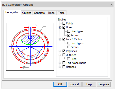

Recognition tab
In this tab you can select a set of algorithms that will be used when vectorizing a raster image.
Recognition tab
Different types of raster images should be vectorized using different sets of entities. For example, to vectorize images of maps or sketches, you should use polylines that approximate raster curves of arbitrary shape, and when vectorizing engineering drawings – algorithms that create segments, circles, arcs, then the vector drawing will most accurately reproduce the original drawing.
To ensure the possibility of optimal recognition of images of different structure, the Graphics Editor uses several vectorization algorithms that recognize raster analogs of vector entities and generate approximating vector objects of the corresponding types. You can use one or more recognition algorithms in one vectorization operation.
The tree of algorithms is located in the right part of the Recognition tab. At the first level, there are recognition algorithms. To enable the desired algorithm, check the box next to its name. The second level of the tree contains additional functions and parameters of the corresponding algorithms.
The vectorization process is also directly influenced by the geometric recognition parameters located in the Options tab of this dialog box.

Lines
Includes line segment recognition algorithm. As a result of the algorithm wor, straight lines are created.

Arcs and circles
Enables the algorithm for recognizing raster circles and arcs.

Polylines
This algorithm approximates the center lines of raster objects by polylines. The algorithm creates polylines consisting of straight segments only. You can use this algorithm alone or in conjunction with the Outlines algorithm when vectorizing maps and other images consisting of arbitrary lines (i.e., hand-drawn lines).

Outlines
This algorithm is designed to approximate the outlines of filled areas by polylines by creating closed polylines that approximate the boundaries of raster objects. Contour polylines consist of straight segments only.

Text areas
Enables the text recognition algorithm. The program finds image fragments containing raster texts and applies an operation specified as an additional parameter of the algorithm to the found texts.
