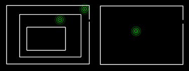

The preliminary search for contours is background and during its process you can specify the desired contours by clicking the mouse inside the contour. Selected contours are marked with green dots:
After contours precalculation is completed, the specified contours are selected for hatching and the points are erased. If there are breaks in the contours greater than the Gap tolerance parameter, the point indicator turns red:

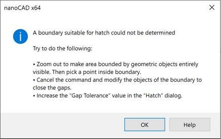

A message is displayed suggesting solutions to the detected problem:
To deselect the problematic contours, click OK and click on the red dot again.

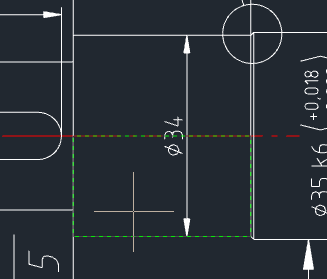

After a preliminary search, the found contours are highlighted in green under the cursor:

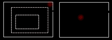

If you hover the cursor over contours with an allowable gap value (the value of the Gap Tolerance field) – red. In this case, the locations of the gaps in the contour are outlined in red circles:
