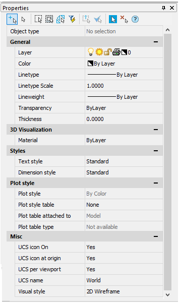

The Properties bar is used to display information about selected objects, to change objects’ properties, to set selection mode and to launch selection commands.

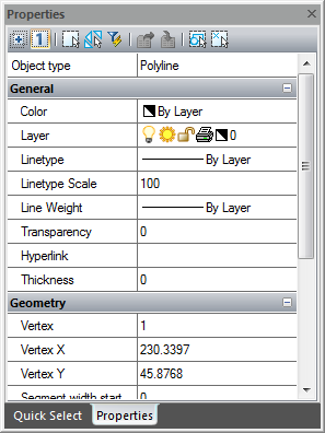

The Properties bar can be combined with other functional bars, such as Quick Selection, Drawing Explorer, Tool Palettes and other. You can switch between merged functional bars using tabs in the bottom part.

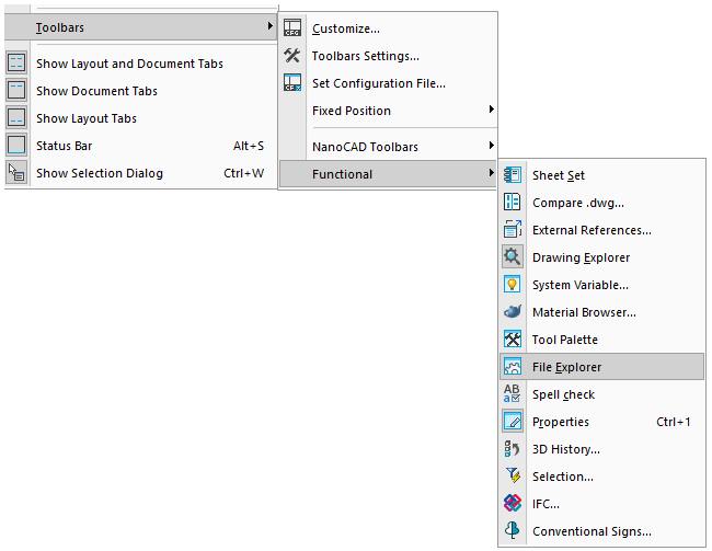

Functional bars can be shown/hidden from View – Toolbars > Functional menu or from right-button menu in toolbars area.
as well as in the context menu called by the right mouse click at any toolbar.

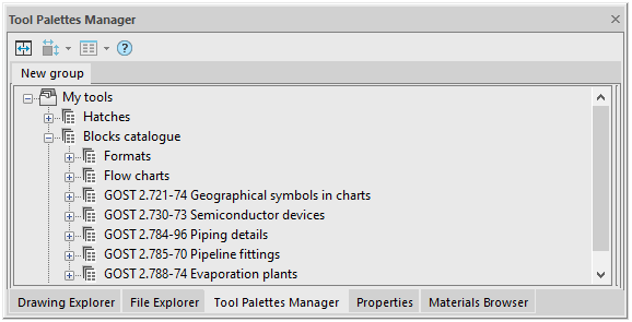

Combining tool palettes
To save drawing space, tool palettes can be combined. In this case only the active palette will be displayed on the screen, while the rest ones combined with it will be displayed as bookmarks. You can switch between combined palettes using bookmarks located in the bottom of the active palette.
To combine tool palettes , drag the title of one palette onto the title of another one. The order of tabs can be changed by dragging. To separate a palette, click on its tab and drag it into a drawing field holding the mouse button.

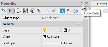

A palette attached to the window can be switched to the state of a pop-up tab. To do this, click on a pushpin icon in the toolbar header:
