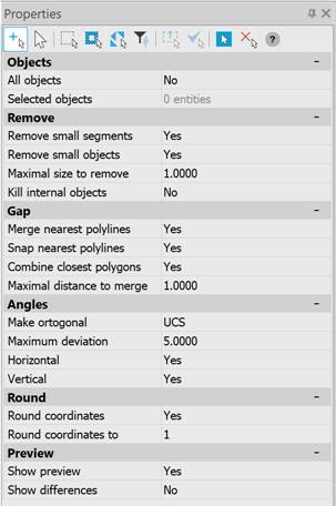

Vector correction parameters should be specified in the Properties (INSPECTOR) bar.

For vector correction:
1. Run the Vector correction command to correct all objects in the drawing or pre-select objects in the drawing and then run the Vector Correction command. If it is necessary to add objects to the selection, click the CAD drawing Vector Correction 8 button in the Selected objects line.
2. In the Properties bar, select the necessary correction options in the Remove, Gap, Angles groups.
3. Enable Yes options for the Show preview and Show differences options in the Preview group to track changes on the screen.
4. Select Yes in the command line to apply the correction.
