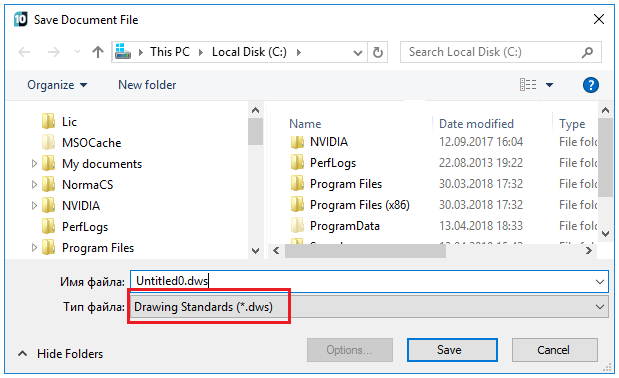

After the standard is defined, it should be saved in a standards file – a file with DWS extension. One standards file can be associated with several drawing files. A drawing associated with a standards file can be checked for these standards violations automatically and manually.
To create a standards file, open a new document, in which configure layers, dimension styles, linetypes and text styles in accordance with the established norms. Then save the document in DWS format using Save as command.
DWS-files should be saved in the current program version format. To save a DWS-file in a previous version format, first save the file in the desired version DWG format, and then rename it by changing extension to .dws.
