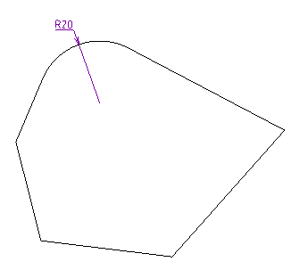

Measure fillet. Tabulated fillet radius and the number Extra measurement. Stamped dimensions of the original geometry. Active only when the button “dimensioned pairing”

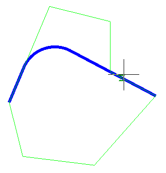

polyline – Switching to chamfering along the selected polyline. This option is available if you have selected the type of symmetric Circle: one length or two identical length. In operation, the cut-off modes are ignored and dimensioning.

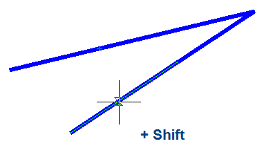

If you select the second object, press and hold SHIFT, then the angle will be formed (at the intersection of the closure and isolation).

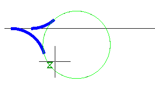

For a pair of ARC-ARC additionally available pairing, combining internal and external touch.
Availability of different types of interfaces depends on the fillet radius. To the outside and combining the radii need greater magnitude than the inner.

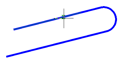

When two parallel lines will be constructed pairing radius equal to half the distance between them (regardless of the specified length). Automatically aligns the sides to the longest segment. When two parallel lines will be constructed pairing radius equal to half the distance between them (regardless of the specified length). Automatically aligns the sides to the longest segment.
Pairing works parallel segments and regions of the same polyline.

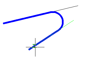

Side interface depends on the position of the mouse cursor when the second object
When you insert a polyline retains its integrity.
If the team is formed of two polylines one, it will be object of a single polyline.
If you select one polyline segments separated by other sites, all the intermediate portions are removed.
