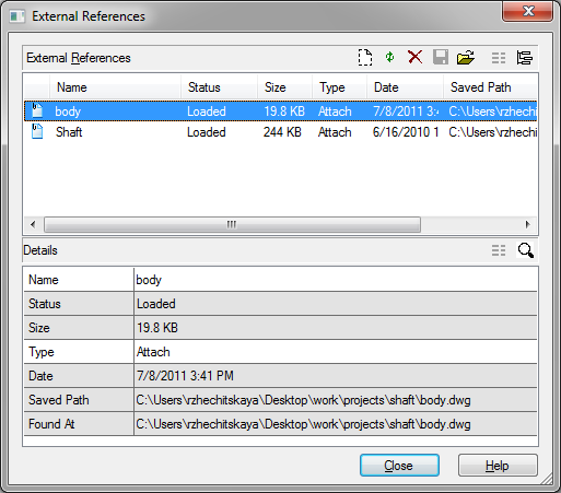

External reference control
The command opens the External References dialog box. It displays all external references contained in the document and manages these references:
The External references palette allows you to perform the following operations with the referenced drawing files:
· Loading/unloading an external reference in the current drawing.
· Binding an external reference to the current drawing.
· Updating an external reference in order to display in the current drawing the latest changes made to the external reference file (without reloading the current drawing).
· Complete removing an external reference insert from the current drawing with all associated data. It is not sufficient to simply remove a reference from the drawing, since such removal would not lead, for example, to removal of layers associated with the external reference. To remove the external reference completely, use the Remove parameter on the External references palette.
· Changing the name of the reference file and its location (path).
· Changing the file type and the format settings of the file of reference to the raster image.

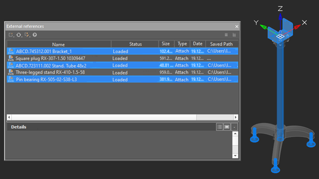

Xrefs selected in the dialog box are automatically selected and highlighted in the drawing. And vice versa: when xref objects are selected in the drawing, their names will be automatically selected in the External references dialog. The ERHIGHLIGHT system variable is responsible for synchronizing highlighting with objects in the drawing. Single and multiple selection is supported (using CTRL and SHIFT):
The options of the External References pane in the Show list:
Columns
| Name | Displays the name of the external reference file |
| Status | Displays the status of the external reference file:
| Size | Displays the size of the attached referenced file. |
| Type |
| Date | The date when the referenced file was created or last saved. |
| Saved Path | Displays the path that is saved with the drawing when the referenced file is attached. |
Left double-click on separator of column names changes the width of columns automatically.

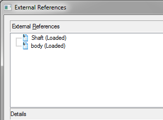

When the External References pane is set to the tree view, a tree structure of all external references along with their levels of nesting within the drawing will be displayed.
