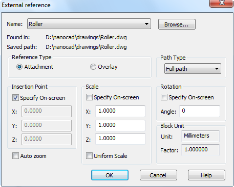

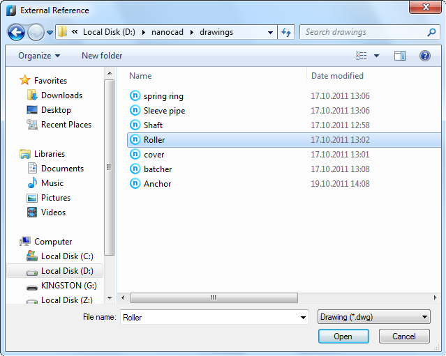

To insert an external reference into the drawing, specify the path and file name in the opened External Reference dialog box:
Select the necessary external reference and click Open. The External Reference dialog box will open.
Parameters:
| Name: | The list of the names of the external references inserted into the drawing. |
Opens the Open dialog box to choose files for the insertion of new references. |
| Found in: | Displays the file path where the external reference is to be found. |
| Saved path: | Displays the saved path of access to the external reference. |
Reference Type
| Attachment | When you attach a drawing file as an external reference, you link that referenced drawing to the current drawing. |
| Overlay | An overlaid external reference is not included when the drawing is itself attached or overlaid as an external reference to another drawing. |
Path Type
Choose the saved path type to the external reference:
- Full path
- Relative path
- No path
Insertion Point
| Specify On-screen | Select the box to set the X,Y,Z coordinates values in the command line or specify the position on the screen. The «X» «Y» «Z» fields of this section are inaccessible. |
| X: Y: Z: | Set the X, Y, Z coordinate values in the corresponding fields of the current document. |
Scale
| Specify On-screen | Select the box to set the scale values in the command line or specify the position on the screen. The «X» «Y» «Z» fields of this section are inaccessible. |
| X: Y: Z: | Set the scale values in the corresponding fields of the current document. |
| Uniform Scale | Set the scale factors on the Y and Z axes to the same scale factor as the X axis. |
Rotation
| Specify On-screen | Select the box to set the rotation angle value in the command line or specify its position on the screen. The Angle field of this section is inaccessible. |
| Angle: | Set the angle value on which it is necessary to turn the reference entry in the current document. |
Block unit
| Unit: | Displays the specified parameter value of the insertion units for the inserted block. |
| Factor: | Displays the scale factor, which is calculated based on the block insertion units parameter value and document units. |
| Auto Zoom | Switches on/off the full screen mode of the inserted reference. |
