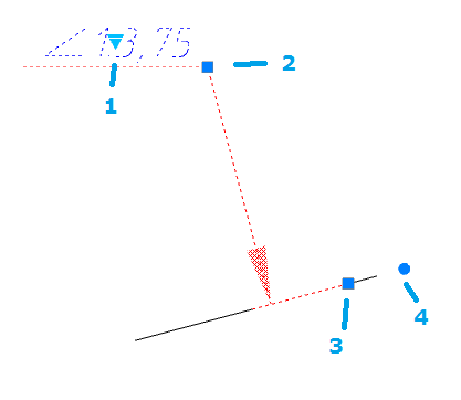

  • “Gradient type” group. Allows you to select the type of gradient symbol:
On section
On plane
Grips
1. Grip for selecting the slope symbol representation.
2. Shelf movement grip.
3. Base move grip. When you move, the associativity with the line is lost and an additional fourth grip appears.
4. Grip for changing the angle of inclination of the base.
