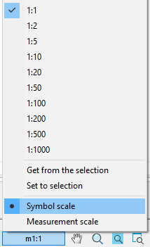

Symbol scale
The scale of symbols can be set in two ways:
1. Set the “Use symbol scale” setting to “Yes”.
2. Select the “Symbol scale” type on the scale button in the status bar (in this method, the “Use symbol scale” setting will automatically change to “Yes”).
Next, you need to select the desired value on the scale button in the status bar.
or in the “Scale” panel.

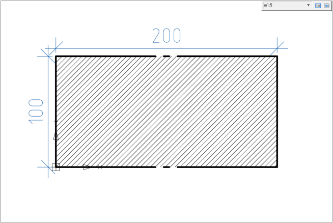

The scale of symbols is characterized by (using the m1:5 scale as an example):
  • design elements (dimensions, callouts, etc.) are inserted 5 times larger;
  • standard database parts are inserted at a scale of 1 (i.e. geometry unchanged) with a current linetype scale (dash length in dashed lines) of 5 (five times larger);
  • geometry is inserted with a linetype scale (dash length in dashed lines) of 5;
  • the displayed size value is taken as is;
  • the mode is signaled by the letter “m” on the “Scale” toolbar.

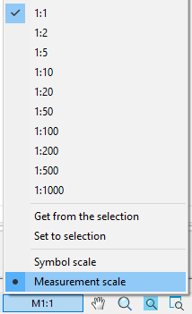

Measurement scale
The measurement scale can be set in two ways:
1. Set the “Use symbol scale” setting to “No”.
2. Select the “Measurement scale” type on the scale button CAD drafting Jobs in the current scale 6 in the status bar (in this method, the “Use symbol scale” setting will automatically change to “No”).
Next, you need to select the desired value on the scale button CAD software Jobs in the current scale 7 in the status bar.

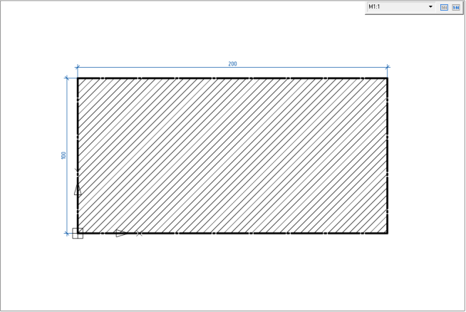

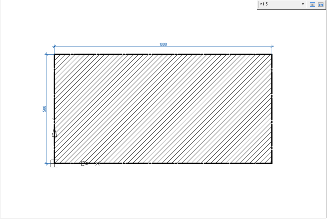

The following is typical for the measurement scale (using the M1:5 scale as an example):
design elements (dimensions, callouts, etc.) are inserted at a scale of 1:1, i.e. they will not change;
standard database parts are inserted 5 times smaller (geometry) with the current linetype scale (dash length in dashed lines) equal to 1, i.e. no changes;
geometry is inserted with a linetype scale (dash length in dashed lines) equal to 1, i.e. without changes;
the displayed value of dimensions (if they are not inside formats and are not associated with application objects) takes a scale factor that is inverse to the current scale (i.e. it will be 5 times larger than the measured one);
the mode is signaled by the letter “M” on the “Scale” toolbar.
