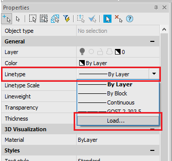

All newly created objects inherit the line type currently set in the Linetype row of the Properties bar.
NOTE: The Linetype drop-down list of the Properties -bar only contains loaded line types, shown in the Linetype Manager.
If a current line type is specified By layer, new objects will have the line types defined for this layer.

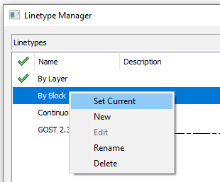

Information about all line types in the document is shown in the Linetype Manger. Linetype Manager allows loading, deleting and renaming of line types. There is a button

NOTE: There is a context menu in the Linetype Manger:
To set a line type as current:
- Select the required line type in the dialog box.
- Click in the left field of the selected line type. The
tag appears, the line type is set as current.
To import line types:
- Click the
Load line type.
