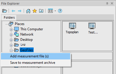

If the command was launched from the context menu of a file selected in the Geounderlays folder in the File Explorer bar, then the specified geounderlay is immediately inserted into the current drawing. You can insert a geounderlay into the current document as an external reference or insert its content.
If the command was launched from the ribbon, menu, or command line, then a file open dialog appears with the Geounderlays folder open, where you should specify the geounderlay file to insert.
