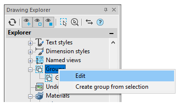

Quick creation of a group
- Select objects on the screen.
- Call the context menu of the Groups section of the Drawing Explorer toolbar.
- Select the Create group from selection. A group will be created and named Group1, where 1 is a sequence number of the created group.

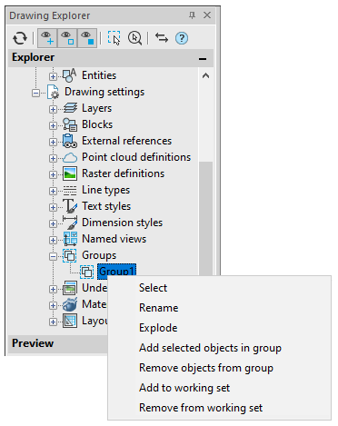

Editing a group
Edit commands are available in the context menu of the selected group.
| Select | Selecting and positioning the group’s objects in the center of the screen. |
| Rename | Renaming the group. |
| Explode | Removing the selected group. Objects included in the group are not removed from the document. |
| Add selected objects in group | Adding preselected objects in a group. |
| Remove objects from group | Removing objects from the group selected in the workspace. |
| Add to working set | Adding all objects of the specified group in the current selection. |
| Remove from working set | Removing all objects of the specified group from the current selection. |
To edit groups in the Object grouping dialog box, use the command of the context menu Groups > Edit…
