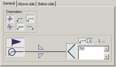

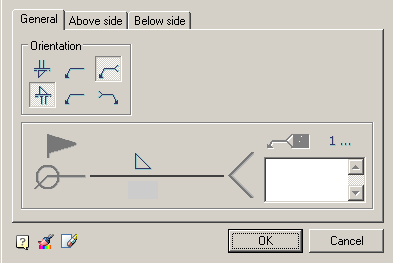

General
On the tab, the graphical display and fill in the drawing note.

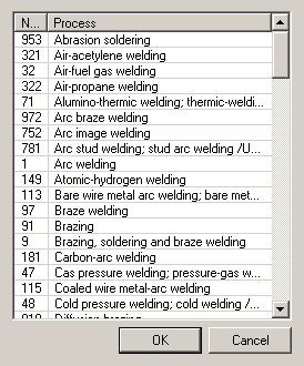

For convenient entry process, you can use Process list.
Process list poddrerzhivaet multiple selection processes.

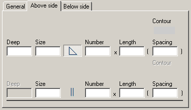

Above side
Tab necessary to fill in the values above the side
The type of weld and its parameters.

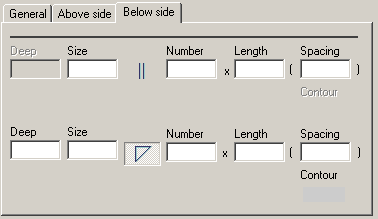

Below side
Tab necessary to fill in the values below the side
