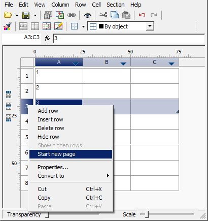

1. Open the table for editing.

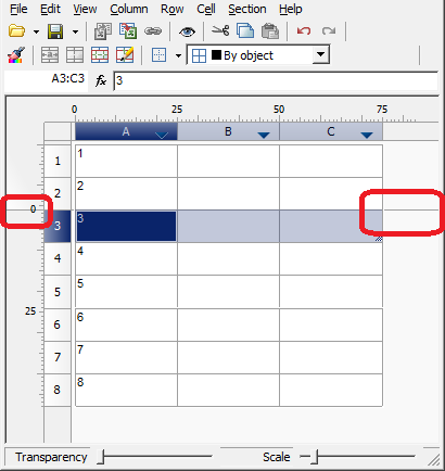

2. In the places where the break will be, set the break with the command “Start new page”.

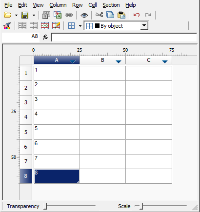

3. Close the editor.

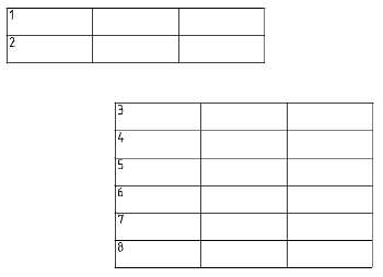

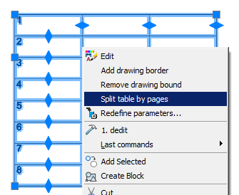

4. Select a table.
5. From the context menu, select the “Split table by pages” command.
6. The table will be split into separate tables. The separation will occur at the places of the established breaks.
