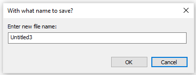

Saving the current drawing to the measurements archive.
Specify the file name (the name of the current one is specified by default).

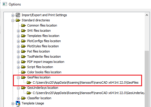

The file is saved to the Geofiles folder.
The path to the folder is determined in the Standard directories section of the Options dialog
