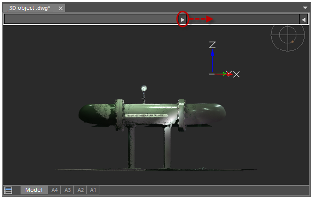

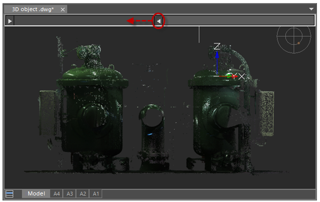

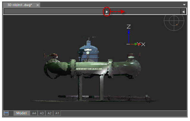

After starting the command and selecting the desired mode for specifying the clipping planes, you should adjust the position of these planes by moving the slider grips in the upper part of the workspace. Initially, the front plane is located at the point of view, and the back one at the maximum distance.
Display mode for both clipping planes. The position of planes is not adjusted:
Moving the front clipping plane away from the viewpoint while clipping the front objects:
Moving the back clipping plane towards the point of view while clipping off the background objects:
