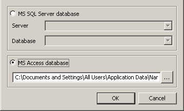

When you click on the button in the “Data source” field, the dialog for specifying the data source appears.
nanoCAD Construction provides work, both with local databases, and with the database on the MSSQL server.
If you are using an MS SQL database, you must select the “Data Source – MSSQL” radio button. In the “Server” field, specify the server name (along with the name of the SQL Database Server Instance). For example: SERVER, or SERVER\SQLEXPRESS. In the “Database” field, you must specify the name of the database to which you are connecting.
If you are using a local database,you must select the “Data Source – Local Database” radio button, and then specify the path to the database file.
For x64 computers, files in the *.mdf format (LocalDB, for Windows 7 and above) are used as a local database.
The necessary drivers are installed automatically during installation nanoCAD Construction .

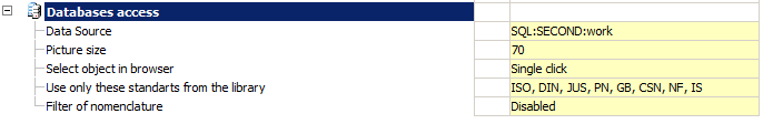

Picture size
The size of the preview image for the database elements in pixels.
70 140
Select object in browser
Single click
Dowble click
Use only these standarts from the library
Restricting the used standards filter.
Filter of nomenclature

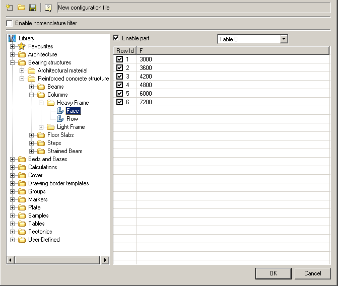

The filter editor is called by pressing the button with the ellipsis. As a result, the settings window of the nomenclature filter appears:
In the upper part of the window there are buttons for creating, downloading and saving files of the nomenclature filters, as well as a switch for enabling / disabling database filtering according to the selected filter. nanoCAD Construction allows you to switch between different filters and temporarily turn them off.
The structure of the database is displayed in the left part of the window nanoCAD Construction , the icons of which show the current state of each element of the database:
*the standard icon of the database element. Indicates that all sizes and the element itself are allowed to be used. *prohibition to use icon. Indicates that this element is not allowed to be used. *use icon. Indicates that this element is allowed for use with a limited set of standard sizes.
To enable / disable the use of the entire element, use the “Allow part use” switch. To disable a specific part size, you must uncheck the column ID of a line of this size in the part dimension table.
