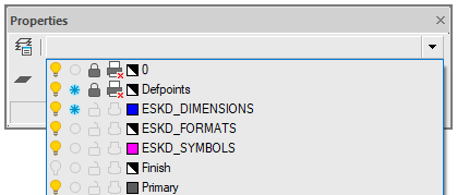

The Layer drop down list allows reassigning of the current layer, and also switch on/off, freeze/unfreeze and block/unblock a layer:
