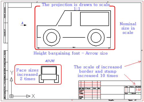

Example of projection drawing frame, increased 10 times
Insert
The frame and title block are inserted in the model space. The scale is set in relation to the main views (reduced or increased).
The main views are performed in the 1:1 model space.
Additional views, sections, and cross-sections are drawn with scale factors that differ from those of the main views.
Features design drawings
When inserting dimensions, it is necessary to take into account the scale factor of graphic (size of dimension text, size of arrows, indents, etc.) and numerical designations for each type. Let’s say the frame is enlarged 10 times in relation to the main type. In this case, the size of the dimension arrows, the height of the dimension text and other text designations should be increased 10 times. And the nominal value of the dimension text for the main types should be set in a one-to-one scale.
When applying dimensions to views made at a different scale (in our example 1:20), the nominal size must be multiplied by the scale factor.
Especially when printing
In this example, the sheet is printed at 1:10 in order to maintain a standard frame size, title block text and symbols. Such technology is not supported Construction Site .
