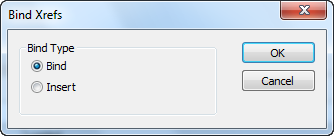

4. In the box Bind xrefs select the bind type: Bind or Insert.
5. Click OK.
