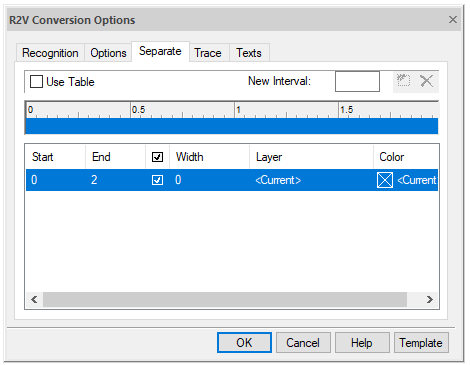

All intervals are created within the thickness range from zero to the Max. thickness specified in the Options tab of the same dialog box. The initial contents of the table are as follows:
Original content of the thicknesses table

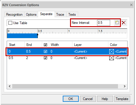

Creating a new interval in the thicknesses table
Enter the value of the upper limit of the thickness interval in the New Interval field, click
You can create an interval by left-clicking on the desired place in the thickness table ruler.
The existing interval, which contains the specified thickness value, will be split into two intervals. The properties of the new interval are inherited from the existing one. An arrow appears on the ruler to show the position of the upper boundary of the created interval.

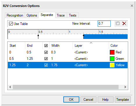

Each interval has the following properties: measured thickness (Start and End columns), specified Width,Color and Layer.
During the vectorization process, these properties will be assigned to objects that have a thickness within the given interval.
Interval properties

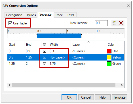

When the Use table box is checked, the value specified in the Width field is assigned to all vector objects whose width is within the specified interval.
If you do not need to round off the line thickness within the interval to the values preset in the Width field, clear the checkbox in the corresponding line of the interval properties.
Specify the interval width
Select with the mouse the row of the thickness table corresponding to the desired interval, and then click in the *Width *column.
Enter the required value.
