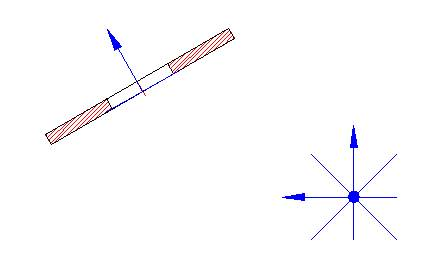

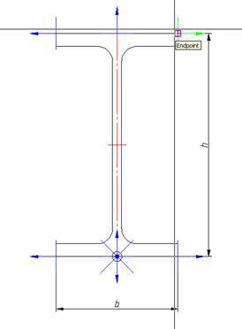

Specifying the object plane
Target abstract object geometry (points vectors planes) may be in coordinate form (almost not used) or relative to the local coordinate system. Position of the points defined by specifying operators addition point and plane. In the example, the position of the reference point is defined as the plane
pntWP4=pntOrigin+vecDirection*(b/2)+vecPlane*h Normal vector of the plane collinear insert vecDirectionConsequently, she illuminated plane WP4 will be set as
WP4=Plane(pntWP4,vecDirection); If the surface normal vector is not orthogonal coordinate system, it is often determined by the operator or RotateBy GetLocalNormal.For example, for lining the conical bottom, surface normal vector is defined as the WP2
vecNormal=getLocalNormal(vecDirection,vecPlane); vecFitting = rotateBy(vecDirection,90-ang/2,vecNormal); //ang – is the angle of the bottom in terms of Apart from the above identified, operators are used to find the vector normal plane and the base point: pntWP1 = Point(WP1); vecWP1 = Vector(WP1); To find the distance between the point and the plane used the difference point and plane rDistance = WP1-pntOrigin; Vector length (distance between points) define the operator vecLen: rLength = vecLen(pntWP1 – pntOrigin); Orthogonal vector operator is getPerp:vecPlane = getPerp(vecDirection);
