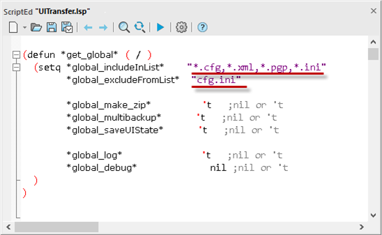

Editing the file package composition
If necessary, you can edit the LSP file describing UIIMPORT and UIEXPORT commands, and change (delete or add) formats and particular files included in the exported package of settings.
The UITransfer.lsp is located in the folder C:\Program Files\Nanosoft\nanoCAD xх.х\Lsp.
NOTE: Before making any changes to UITransfer.lsp, make its backup copy to prevent loss of a correctly functioning file.
In order to edit the file, open it in any script editor, for example, in nanoCAD Script editor.
The global_IncludeInList line specifies the file formats and files that will be included in the set. By default, these are CFG, XML, PGP, INI formats.
The global_excludeFromList line specifies the file formats and files to be excluded. By default, this is the Cfg.ini file. By adding or removing formats and files, you can change the resulting settings package.
Save the modified file.
