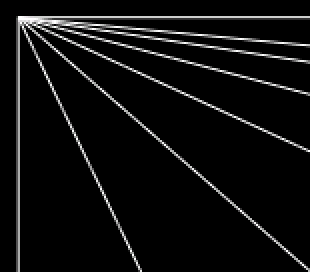

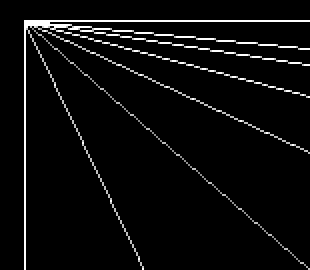

Antialiasing
Enable Use anti-aliasing check-box to smooth lines on the drawing:
Anti-aliasing does not work when Improved compatibility mode is enabled.
