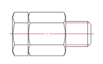

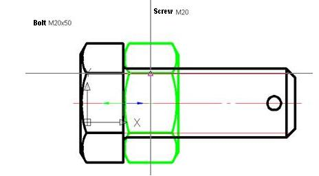

The thread diameter parameter (dr) of the screw is equal to the thread diameter parameter (dr) of the bolt (dr=dr).

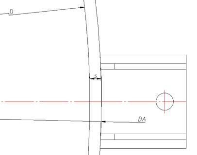

When setting the support for the shell, the dependence of the parameters’ arithmetic expression is set: the diameter of the support is equal to the sum of two shell widths and the inner diameter of the shell. DA=D+2*s.

INSERT – the combination of the insertion points and planes’ vectors. The function has a parameter – offset – the distance between planes’ points of the detail along the OX axis.
MATE – the collinearity of the direction vectors if the abscissae of the details are relatively equal. There is a parameter – distance along the OX axis.
AXIS – the combination of the direction vectors with the unfixed coordinates along the OX axis. The parameter of the dependence – distance along OY axis.
The combination along direction (angular dependence) – the collinearity of the direction vectors with the unfixed relative coordinates.
The geometric dependences can be codirectional and opposite directional according to the orientation of the local vector of the OX axis.
