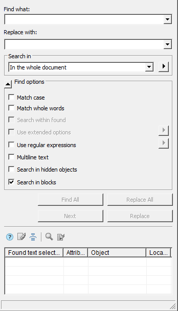

1. Call the command. A dialogue will open “Find and Replace”.
2. In the “Find what:” field, enter the search phrase.
3. Select “Search in” from the list, or by using the additional button CAD drawing Find and Replace 11 that defines the search area. The button action depends on the context of the “Find and Replace” command call. If the command is called from the object manager, the “Quick selection” window opens.
4. Select search parameters :
  • Match case. If the flag is set, the search is case-sensitive.
  • Match whole words. If the flag is set, the search is performed for individual words, that is, combinations of characters separated by punctuation marks or spaces.
  • Search within found. The switch is available after the string has been searched and limits the search range.
  • Use extended options. The switch is available when searching in the object database. Click the button opposite the parameter and in the window that appears, select the advanced search areas.

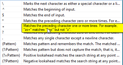

  • Use regular expressions. Enables search mode with additional selection conditions. Click the button opposite the parameter and select the required expression from the list that appears. When you hover over a list item, a tooltip appears with a detailed explanation. The choice of expression is made with the left mouse button. Multiple regular expressions can be used together.
  • Multiline text. Turns on the search mode for multi-line text.
  • Search in hidden objects. Turns on the mode when both visible and hidden objects are searched.
  • Search in blocks. Turns on the mode when the search is carried out inside the blocks.
    5. Click the “Find all” button, the search process will start.
