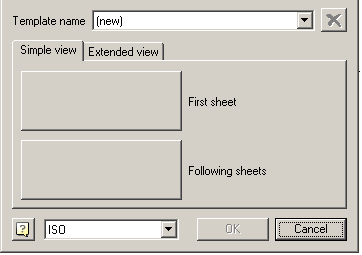

To change an existing stamp, select it from the drop-down list of templates.
To add a new format, select the drop down list “Template name (new)”.
A template stamp can have up to four different graphical representations: simple and full (advanced) type, including the form of the first sheet and the view for subsequent sheets.
Select one of the tabs: “Simple view” or “Extended view”. Click the left mouse button on one of the fields marked with a stamp type, and select the drawing template you created earlier mock punch. Confirm the selection click OK.
In the dialog box “Create stamp” will be recognized image of the stamp.
If you create a new stamp, after closing the dialog box by pressing OK, a dialog “Create element”, where you must enter the name of the stamp, and choose a library of standard parts folder in which to save the template created by the stamp:
