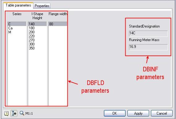

[DBFLD, D, Dn, … ,]
[DBINF, Number,Seria,…,]
[VFLD, rA, “A”, rB, “B”, … ,]

DBFLD – keyword, after which the table’s parameters are listed.
D,Dn, … – names of the table parameters.

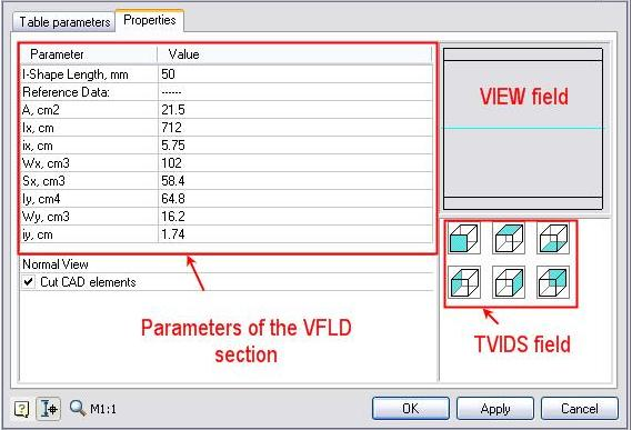

VFLD- keyword, after which the object’s parameters are listed, announced in the Public or Protected sections.
rA,rB, … – names of parameters with the comments.

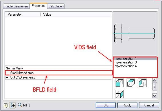

BFLD – keyword, after which the checkboxes are listed – variables, taking only 1 (CHKD) and 0 (UNCHKD).
bKey1, “Key1”,bKey2, “Key2” – names of the variables with names of the checkboxes.
A block of the parameters, starting form the BFLD keyword, is a list of the dialog’s components, which are standard CheckBox(es) and has two modes: Checked and Unchecked. The parameter-variable, going after the BFLD, according to the checkbox mode takes 1 for Checked and 0 for Unchecked values. Such checkboxes are used for describing the properties of the standard objects in the application.

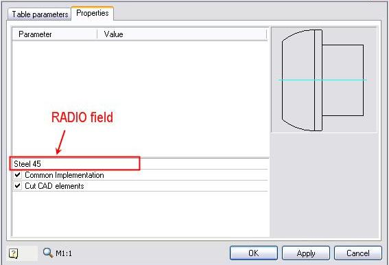

RADIO – keyboard, after which the group checkboxes are listed – variables, taking discrete integer values.
rKey1, “Variant 1”, “Variant 2”, … – names of the variables of the group checkboxes with names of selection variants.
A block of the parameters, starting from the RADIO keywords, is a list of the dialog’s components, which are standard drop-down lists with the permanent number of the unchanged strings. The parameter-variable, going after the RADIO, takes the index values of the selected string in the ComboBox. The top string has 0 index, the last is a subtraction of the number of strings and 1. Such checkboxes are used to select a material for the standard object in the application.
For the described example, the bCommon parameter takes 0 or 1 integer values, and the rd1 parameter takes 0, 1 or 2 values.
Parameters for the BFLD and RADIO can be described in the Public and Protected sections. Before activating the dialog, such parameters should be initialized (usually in the OnInitialization).
VIDS- keyword, after which all an object’s implementations are listed.
strDesignName, “Design1”, “Design2” – variable’s name, storing the name of the object’s implementation with the available implementations’ names.
TVIDS- keyword, after which the object’s views are listed.
lViewType- variable, storing the name of the object’s view and taking values from the multitude {VFRONT, VRIGHT, VLEFT, VTOP, VBOTTOM,VBACK}.
“F” – view name “Frontal”.
“R” – view name “Right-side view”.
“L” – view name “Left-side view”.
“T” – view name “Plane view”.
“B” – view name “Bottom view”.
“All” -names of all views.
VIEW – keyword, after which the slide’s type goes from the multitude {“Vids”, “Hdr”, “None”}.
“Vids” – implementation’s slides of the object
“Hdr” – slide of the object’s header (Header)
“None” – there are no slides
