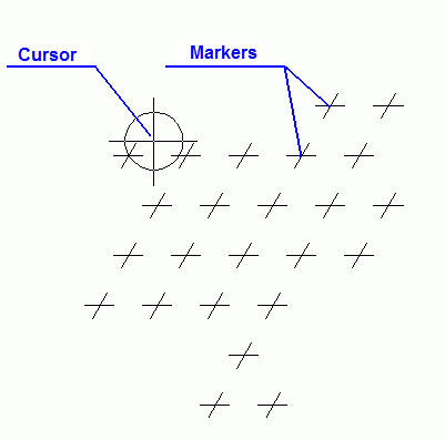

“Paint area”. The command allows you to specify an arbitrary placement of copied objects, providing a set step between adjacent copies. This command is available only after selecting the source objects to copy.
The construction of the area is carried out by moving the mouse cursor over the drawing (construction must be started from the location of the original objects). As you move the cursor, markers will appear on the screen to indicate where the copied objects are inserted.
To remove insertion markers, press and hold the “Shift” key. When you hover over a marker, the marker will be deleted.
To temporarily disable the placement of markers, press and hold the “Ctrl” key.
Finish drawing the area by clicking LMB. An array by area will be built.
