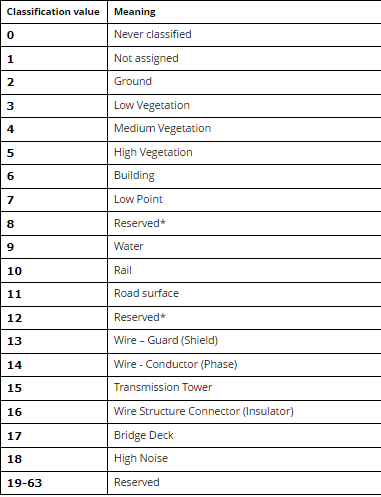

Classification codes for LAS versions 1.1 – 1.4 assigned by ASPRS

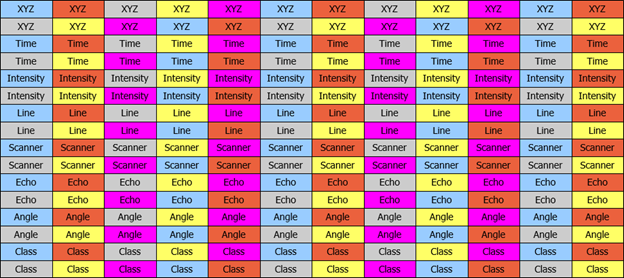

The file structure looks as follows:
Point cloud attributes are stored in blocks: first a point coordinate block, then a time block, then an intensity block, etc.
The advantages of block storage:
  • Possibility to read only the necessary attributes of points, this saves RAM and reduces the time for reading a file;
  • You can save only the required attributes;
  • Time stamps are now stored in GPS Standard Time format.
